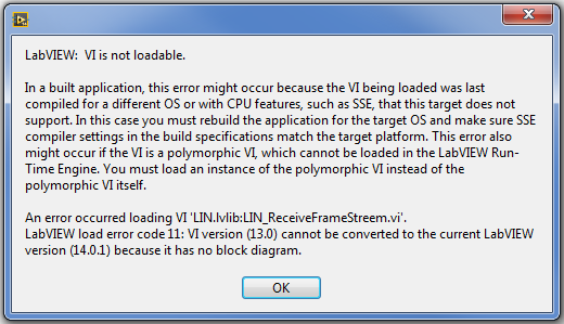

When I run your sub VI from project is appears error below, I think that you can resolve it.
Message 7 of 12
(13,158 Views)
You must run in LV2013, I have that version, and build this with LV2013.
