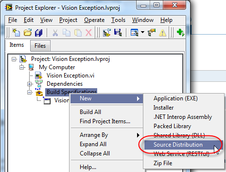

Something like that:
Andrey.

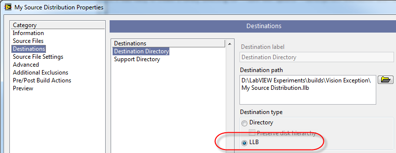

The way described above mostly the same, but more flexible. Once Build Spec is created, you can recall it with single mouse click, removing BD/FP and so on - most things are under your control.
Another possibility for source code distribution is "ZIP file" (available in the same menu). With Zip file the entire project can be compressed into the single archive (but not in llb, of course).

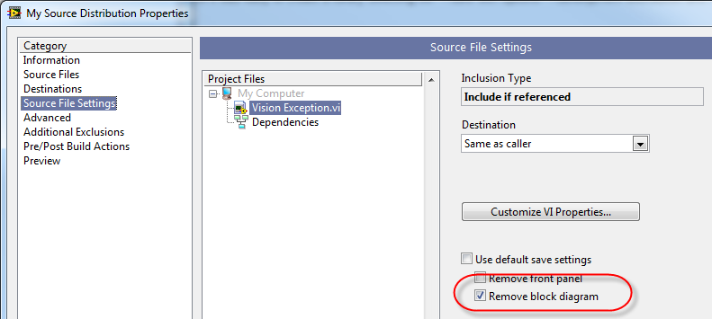

With distribution into llb I can define which VIs should be excluded from distribution:
But I can't do the same with packed libraries:
In some rare cases (complex PlugIn architecture, for example) this might be necessary.
