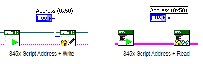

I do not have the USB-8451 to check this myself, but based off of this document: http://www.ni.com/white-paper/5767/en/ I would guess you should be looking into these two VIs:
Advanced LabVIEW API for Device Addressing
Use the Script Address + Write or + Read Functions after a Script Issue Start function to program the device address.
Note:  This, however, is just a shot in the dark.  It seems like deep down they are calling a library, so it may be out of your control unless you have access to the library being called as well.

Sorry  MrHappyAsthma but the advanced adressing didn't worked... I think i may have to modify one of the adressing vi in order to transfer my frame in little endian...
