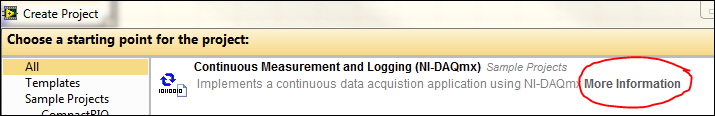

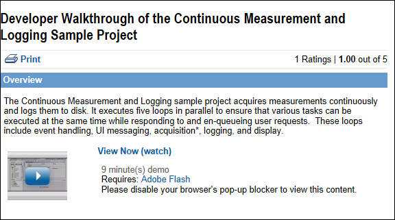

It Appears that NI thought to include some really amazing things in the feature! See that "More Information" bold text?  It gets you right to here

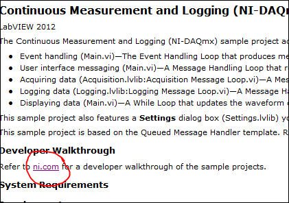

Of course that template help suggests you read this which goes into much more detail about the Queued Message Handler Template and how to modify it.
Both of them contain this link:
Those links take you here or Here
Where the actual developer of the template will walk you though using the template you chose!
Really, this feature might just start hurting my Forum Post count.Smiley Very Happy

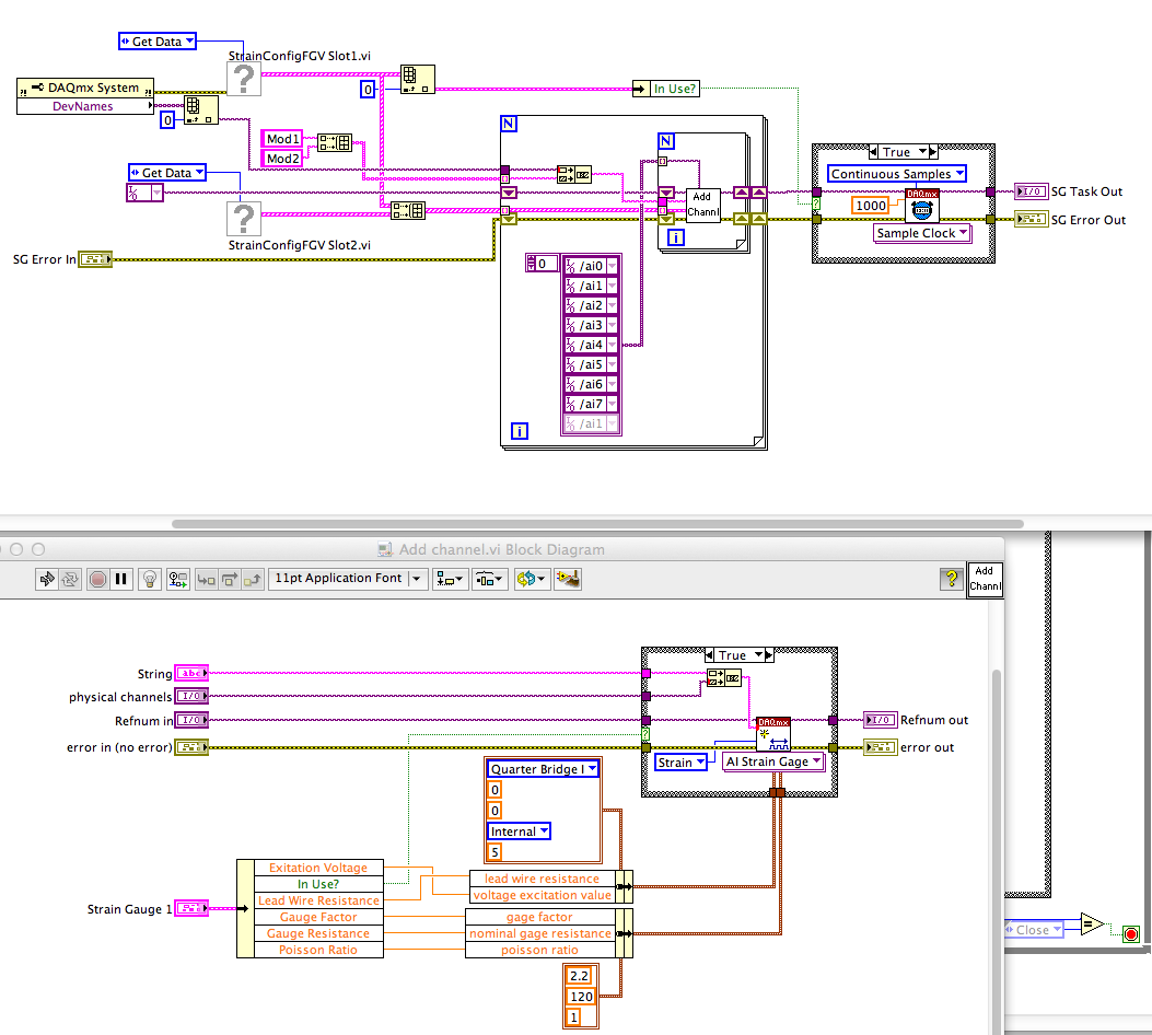

Your Strain Channel Setup SUB.vi has way too much duplicated code. If you ever need to change anything in there, it will be a big job to make sure each change is correctly made in 16 places. Create an Add Channel to Task subVI. Place it in a for loop with autoindexing of the arrays.  That block diagram which was about 4 screens in area now fits on < 1/4 of a screen.  Also make the Strain Gauge 1 cluster into a typedef. Then any changes only need be made to the typedef and they will propagate throughout the code.
