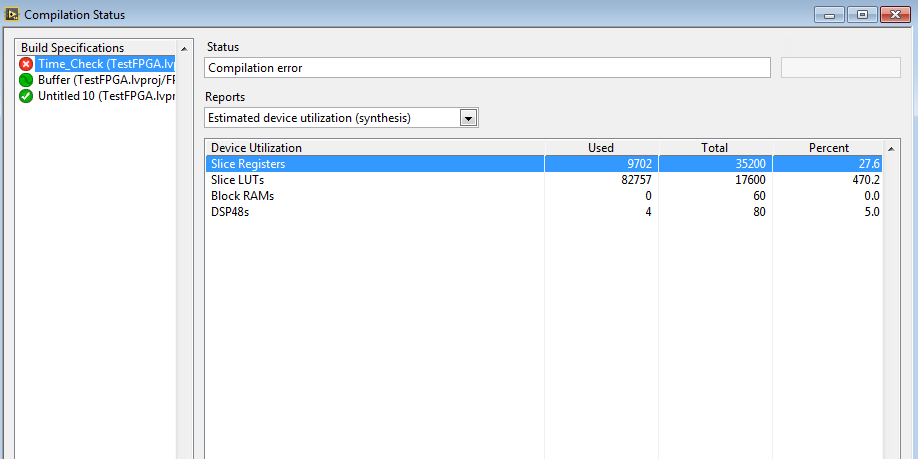

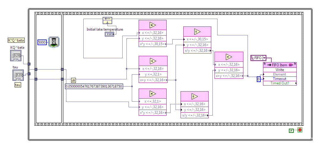

Good morning, I have a question about LUTs and DSP48s resources at my myRIO FPGA. So, I have a really not complicated piece of code, which I am trying to compile on my FPGA. Its how it looks like:
12121.png I have here some high thoughput math calculations, so I thought DSP48s resources will be used. But unfortunately, only LUTs are used, and even though there are only some blocks, my compilation status looks like this:
How is that possible? 470.2 percent? Maybe I have something wrong with my setting, or maybe something is broken.. I would appreciate aby kind of help.

Also it looks like you are performing a division with a known value since it's the sum of a control value (tau) and a constant (0.05).
Since division on FPGA is very expensive (and time consuming) it would be more efficient if you could calculate M = 1 / (tau + 0.05) on your host and perform a multiplication by M on your FPGA instead.

Ok I am attaching my VI (Buffer.vi) (in LabVIEW 2014, if earlier version is needed, let me know)
LocalDSP, I would prefer to have my calculations on the FPGA, as I am reducing the participation of the host to minimum. Its dynamic host interface (more fpga bitfiles), so that is why there is tau control at the beginning.
And beside that, isn't it still weird that two division calculations would take almost 500% percent of my LUTs resources? I am really confused 😕 Thanks you for feedback!

Ohh, and I also forgot to add, that I tried to do something simillar using DSP48e blocks, which were set to divide my fixed numbers. And in this case also my LUTs resorces were exceeded.
And here I dont use any Divide Highthroughput Math block. So there must be something I overlook and do not understand.

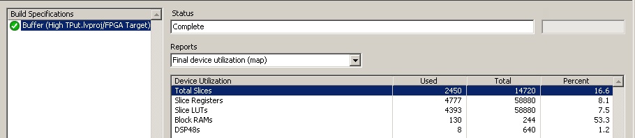

I have to admit it's weird. I've compiled your VI with two different Target-Host DMA FIFO sizes, resp. 1023 and 65535 elements and it passed without problem and with obvious Block RAM increase for the larger FIFO.
Here are the two corresponding compile reports for my used Target (PXIe 7965R). I do not have MyRIO installed so cannot totally reproduce your situation. So somehow it itsn't using BRAM but rather slices on your target.
Target-Host DMA FIFO of 1023 elements
Target-Host DMA FIFO of 65535 elements
