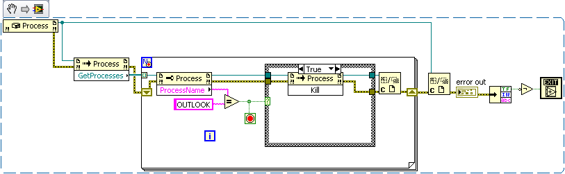

I remember having this problem a couple years ago, My fix was to kill the task programmitcally from my LabVIEW app.  Probably not the best solution in terms of fixing issues in toolkits, but I was in a hurry 😉 Sounds like this was not only my issue.

PJS, interesting solution, not one I think I'd want to use long term, but it might help in figuring out if this is a contributer to our memory full issue.  I am not quite sure how to do that though, would it be possible for you to post an example?

See this thread.

PJS Thanks Very nice VI, it looks like it can come in real handy, I am thinking I might be able to modify it to log memory usage to help us troubleshoot the larger issue.
I am still hoping for a more permanent solution though....id really hate to have to continually add a kill process sub vi to all our excel use instances, as we use so many in our application....
thanks again
