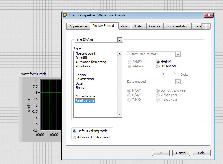

It's easy, just right-click on the waveform control, Properties, Display Format, Relative time.

While the other user's response is correct, this can sometimes lead to a few issues depending on how you are manipulating your data. If at any point you convert your waveform data into double format, the wvfrm timestamp will be lost.
The easiest way I have found of getting around this is to create a property node for waveform chart in question.
Property nodes --> x-axis --> offset and multiplier --> offset
Place this node at the beginning of your code so that upon running, will initialize the plot and override and other defaults that have been set. Feed "get time and date" block into the "convert to double" block" and send this value into the property node you've created. That should do the trick.
