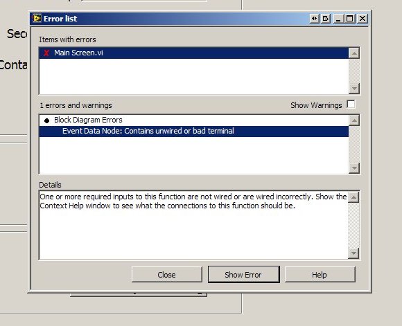

I'm not exactly sure why this is happening as I was able to successfully upgrade this code on a Windows 7 machine.  But on the XP machine I used to originally develop it, the upgrade to 2009 isn't working.
Something is breaking in the event structure.
What I want to ask is;  Is there any way I might recover from this?
22605i8B5CB60AD2A0ADA2
22607iE454F18A8194F521

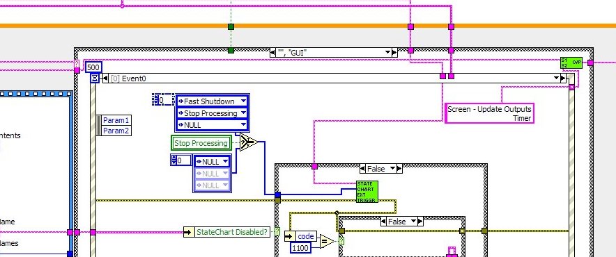

My Event structure has no Event 0.   That should be my Timeout case.  A bunch of stuff is messed up in the event structure now, and I don't think I can fix it.
