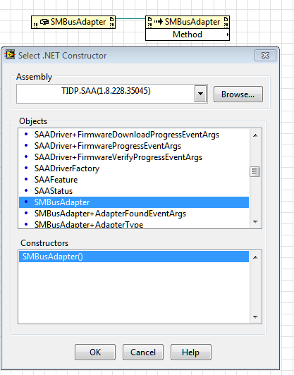

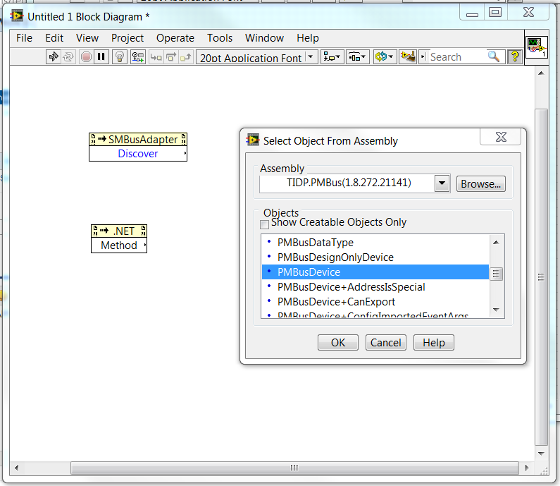

Shown Below: the upper Invoke node shows what happens when you browse to the TIDP.SAA.SMBusAdapter class. THe node changes to SMBusAdapter. You can then select the Discover method.

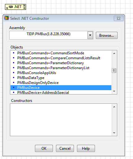

The lower Invoke node shows what the node looks like before AND after clicking the OK button in the "Select Object From Assembly" dialog.
No error is thrown the dialog just disappears and the node does not change.

Hi Macdroid
Not all the .NET objects can be use in LabVIEW. In order to create a .NET object on the block diagram it needs to have a constructor and the PMBusDevice does not have any constructor.

As Esteban already explained there are some limitation in what you can call with the LabVIEW .Net nodes.
I suspect two possible issues here:
1) The object is really a static object and does not have any constructor at all. you should be able to simply place a property or method node down and select the object class directly and then the static methods and properties of that object.
2) The constructors makes use of generic datatypes. This can not really be supported by LabVIEW since LabVIEWs strictly typed datatype system makes that rather hard to do. Not only the technical part of programming it (I'm sure the LabVIEW programmers could do that) but more the configuration part that would have to be added to constructors and method nodes, and where the user would have to make rather involved configuration decisions.
