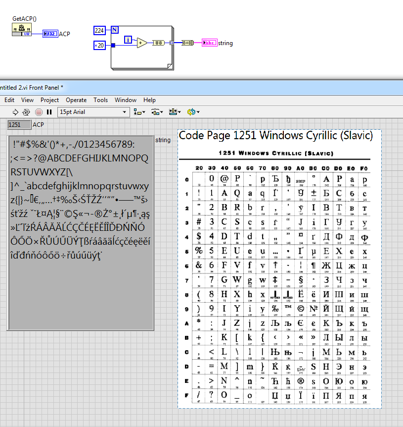

Assuming all that i have a problem understanding why this is displayed:
It should display exactly what is on this codepage? If not can someone explain why it shows this results and some random digits at the end?

Just a tip: each application can have it's own locale. Before Windows 10 you could use AppLocale, now you need pooi.moe/Locale-Emulator/ to start an application with a different locale. Makes switching back and forth a bit easier!
Will have a look at the problem. I think the table shows CP indices VS character. But LV needs MBCS characters, not CP indices. So you need to convert (escape) some of those CP indices. Some indices will need a two byte representation... Can't find an exact algorithm, but I think something like that must be happening.

It's weird:
WideCharToMultiByte converts 3E04 to EE, as expected.
But MultiByteToWideChar converts EE to 3E. To get 3E04, we need to enter 3Exx, where xx can be anything
I'm sure I figured it out before...  Drawing blanks now...

It seems that conversion works file between UTF16 and MBCS for provided codepage. What is the difference between CP and actual MBCS data? I can not find that and my assumption was they are the same thing Smiley Indifferent
So now having proper MBCS data that should be rendered using default system codepage from regional settings.
But when I change from EN to Russian  Cyrillic characters are not displayed correctly, I have tried other fonts but it is still the same.
Do You have any idea what might be the problem or am I doing something wrong here?
Yes, that was just a hunch, based on other CP's that do use escape characters to extend characters (more then 256). But for 1251, I think the bytes should convert to Unicode using the CP in a trivial way. That is, the CP should function as a look up table.
I think it should. But it doesn't.
No ideas. I like to know myself, but I tried and am seeing what you see. I tried MS API's and that shows weird behaviour as well.
So, I'm out of ideas... Not only out of ideas about what's going on, but also out of ideas to further investigate. It just seems to "not work properly"...
