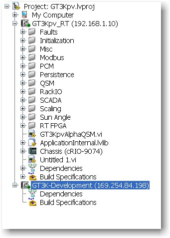

I was hopeful - but all this gets me is a blank target - not even a chassis.
I deployed all to exisitng target (110 front panel windows opening was fun to watch!)
It looks as if discovery of new target only works on primary ethernet port (which set for DHCP - and was disconnected) - so I moved my cable from the secondary (static) to the primary, and eventuially got a new target in the project. Which explains the self assigned IP address.
However, as I said it is empty.
Compare 192.168.1.10 to 169.254.84.198
