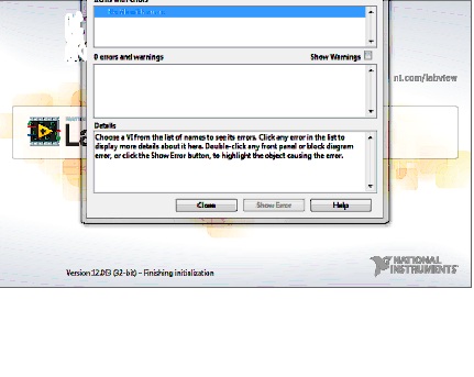

When I start LabVIEW 2012, the error list window pops up shortly and then disappears. Any guesses as why?
It would be helpful to post the picture at a resolution we could read.  😉

It's the default message when no errors exist:
"Choose a VI from the list of names to see its errors. Click any error in the list to display more details about it here. Double-click any front panel or block diagram error, or click the Show Error button, to highlight the object causing the error."
There are no errors to display.

Ahhh, I know exactly what window it is now.  It's the one that, if you click on the broken arrow, shows you everything that's wrong.  When there are no errors, it says so.  it's weird that it would be popping up at startup, not reporting any errors.

So evidently this strange behavior can sometimes be caused by an incorrectly activated/expired Internet Toolkit package.
Are you using this package? If so, try verifying that it is currently activated.

The only toolkits I have installed are the Database Connectivity and the Report Generation.  The License Manager is reporting no deficiencies for these toolkits.

This is odd behavior for sure, and I suspect that this is a bug somewhere in your LabVIEW environment configuration. The only instance I've been able to locate with this error is caused by inactive toolkits.  Do you have any toolkits installed which are not currently activated/have expired activation?  I'll do a little more digging on this issue tomorrow and may end up passing this issue on to our R&D engineers.
