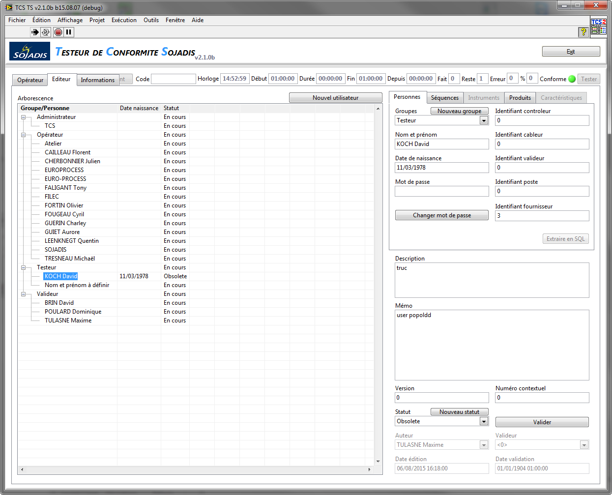

Well, I lied to you, there's not just a single String control,
the whole right part of the panel is composed of controls
being saved on the Value change event :
Hence as soon as I click the Tree control on the left, the
value being edited is overwritten. Nasty nasty Labview.
