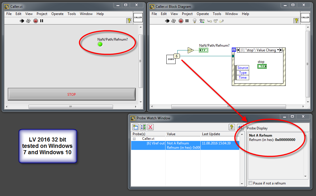

Hello Everyone,
we've tested LabVIEW 2016 on windows 7 and windows 10.
we could reproduce a bug which does not exist on previous labview versions.
About the code:

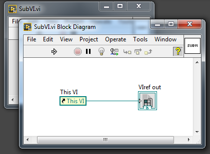

The subVI which outputs its vi refernce to the caller as shown in the picture below.
Caller VI gets the subVI's VI reference through its output terminal.
SubVI refnum is Not A Refnum,
During the first run of Caller Vi
if the subVis frontpanel is not open and the Caller Vi runs
Please give your feedback.

I say bug, and potentially a pretty nasty one at that.  I have had subpanel designs in the past where VI put their This VI reference in globally accessible place, and then a UI can insert them into a subpanel as needed.  That design would break with this bug pretty easily.
Now a work around that fixes this is if you place an Always Copy function inside the SubVI just after the This VI constant then it seems to work properly.  Just another case where the Always Copy icon should be a picture of a band-aid.

Wow.  I missed this, and was so skeptical that I wrote my own little VI and ... Renn and Hooovahh are correct!  I'm also not so familiar with the Always Copy function (fortunately, Quick Drop knows about it, otherwise I wasn't sure I could find it in the Palettes).  I also don't (really) understand (a) why this bug occurs, nor (b) why Always Copy "fixes" it.  Could just be a subtle glitch in the Compiler, I guess ...

This doesn't appear to have anything to do with the front panel being there or not, since this happens in source, and subsequence runs changes the behavior.  This really is just a compiler issue.  And if you aren't familiar with the band-aid Always Copy function, you'll basically find it is a work around for quite a few bugs in LabVIEW.  Here is just a small list that I stopped updating a while ago.
