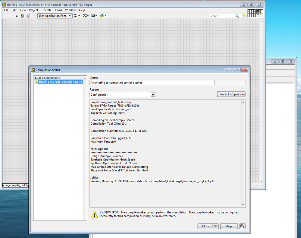

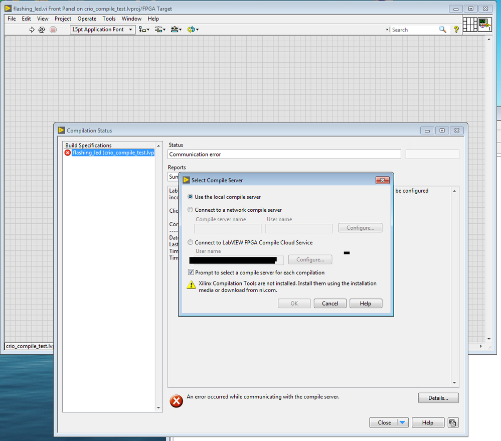

First I get:1.png

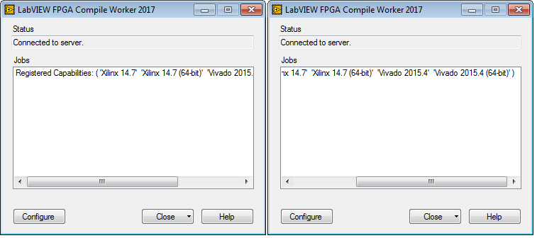

This is the compile worker dialog with all installed software:3.png
