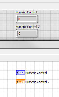

I am not sure when this started but when I right click on an object and select "create indicator" it creates an indicator but labels it a "control".
Sure I am going to rename it anyway but for quick code checks it's nice to have it say what it really is.

This happens with numeric constants.
  1. Place a numeric constant on the block diagram,
  2. right click and select "Change To Indicator"
  3. It changes it to an indicator, but labeled as a control.

Okay it seems that it only happens on the iteration terminal and when changing an unlabeled Numeric Constant to an indicator.
I think I found a bug...

I just checked in LabVIEW 2016, 2015, 2014, and 2013 does the same thing.
Am I wrong in thinking that when you select a numeric constant and  "Change to Indicator" the default label for that numeric indicator would be "Numeric Indicator" not "Numeric Control"?
But it seems like it has been this way for a very long time.
