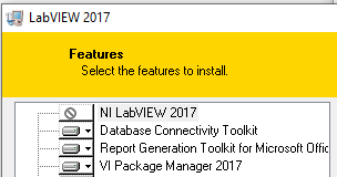

LV2017 refuses to be installed
Has anyone ever seen this?
Is there a reason why NI LabVIEW 2017 is NOT going to be loaded?
I have removed everything in my Program Files and (x86) that it would allow.
I've also removed every other LabView Installation I had on this system.
I've also REBOOTED every time I've tried to Install or REMOVE anything.

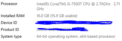

You have not provided adequate description of your PC (such as Windows version and whether 32-bit or 64-bit) and the detailed history of LabVIEW installations and removals, it is difficult to suggest what you should try.  Here are some specific questions:
  1. What version of Windows are you running?  Is it the 32-bit or 64-bit version of Windows?

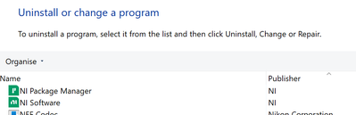

Check in Programs and Features that everything from NI is indeed uninstalled. After Package Manager is uninstalled then there is normally one or two entries left ( here 'NI Software' ) to be uninstalled :
Thereafter there should be no more installations left.
