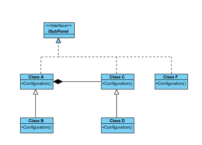

I want to implement LV class interface concept in my project. Below is my class diagram.
I have three different classes Class A&B, Class C&D, and Class F. Each classes are having a Method called Configuration. I need to use a common interface to call this method into a sub panel.
The concept is , If I pass the object of any of these classes into iSubpanel Class ,it should take care below functionalities
  • Calling the Configuration method of that object passed
  • Run Configuration.vi and insert into sub panel.
  • Update the values inside that object into the Configuration method.
Can anyone suggest me how to implement this in LVOOPs.

Are you doing this in the beta version of LabVIEW 2020? That contains OOP interfaces - so you can create what you've drawn in the diagram.
If not, I would recommend writing a subpanel class and putting a 'subpanel class' object as part of the other classes (encapsulation), then using bundle/unbundle to access it, from there you can use the subpanel class API.
That or...
You could have all the classes inherit from a 'User Interface class' that defines the subpanel methods. Tread carefully though - this can be a blessing or a curse.

Actually I don't want to consider the subpanel reference as the property of my class.Because I m planing to maintain only properties related to that class as I need to use this same class reference in LabVIEW RT also. In my project I will do configuration in Windows and Execution in RT Target.Configuration is nothing but updating all the value into properties of that class and Execution actual functionality of that object.
Can you help me to make malleable VI and interface class to handle this. I m really not sure about these two.
Also I have already implemented the same as you suggested , Now I m optimizing by removing unwanted properties from class. I have properties like subpanel reference and Tree reference etc etc . I need to take out all these from these classes and optimize  it for better performance.So I m looking for something like interface concept.
