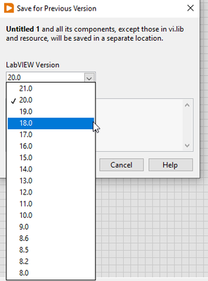

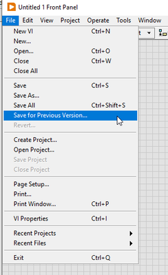

AmanAman,
To make it easier on yourself (and others), use the Save to Previous (under the File Menu) feature. Version 18 should be sufficient unless others chime in. Name it differently and attach.

(I can do version 2020 or anything lower)

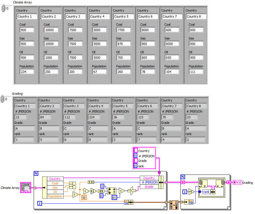

Thank you for the response. To clarify "Add another element to the cluster that indicates rank" is exactly what I meant. I haven't been able to physically write any code because I am brainstorming on how to approach this and haven't came out with a way to do it. Some of the ways I thought about doing it was to use the same grading methodology, however, that would result in multiple countries being ranked the same. Another way I thought about it was to do a series of booleans to compare the individual values, however, this seems very inefficient and probably not possible. If you could steer me in a general direction I can see if I get it figured out.
Message 18 of 23
(4,834 Views)
Accepted by topic author AmanAman
All you really need to know is that in LabVIEW, sorting arrays of clusters will sort hierarchically by cluster order.
So here's how that could look like. Make sure you fully understand it:
Message 19 of 23
(4,829 Views)
