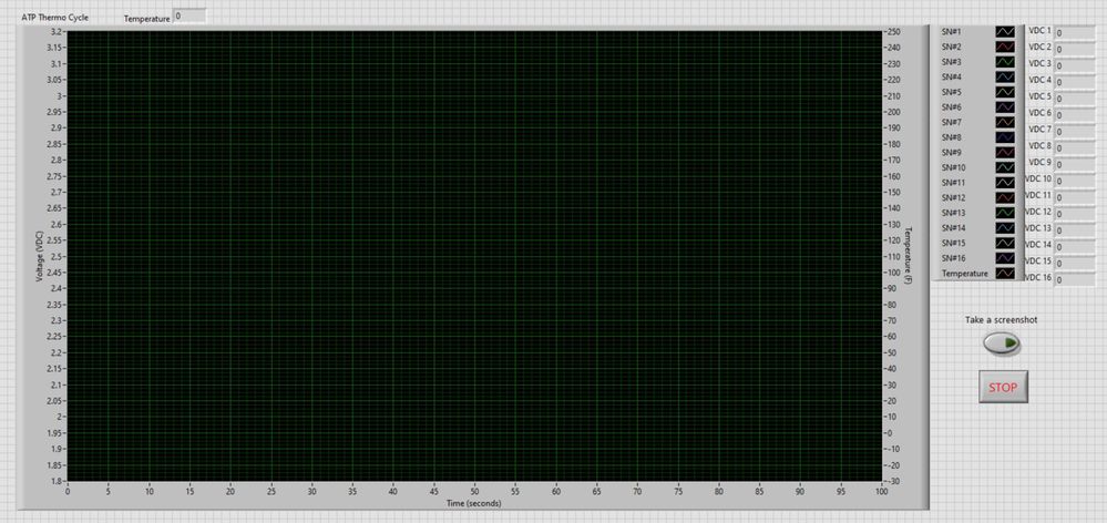

Good evening, I am very new to LabVIEW and starting to get into it. I have searched around but maybe not enough but cant find what I need. I have created this program that monitors the bias voltage of 16 sensors and the temperature of the environment they are in. The test I will be performing will last for 10 days and I want to take a screenshot of the plot every 60 min. Does anyone have a template or can point me in the direction that will do such? I have the manual capability but need to have it automated. A bonus would be if I could get the raw data to an excel or txt.

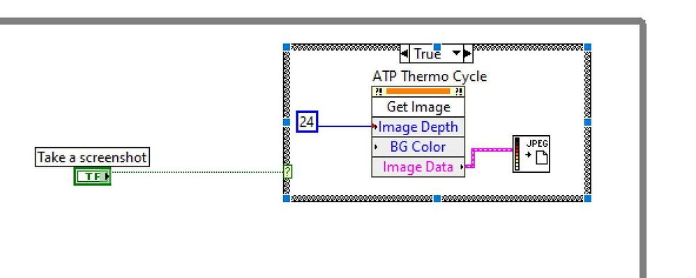

Well you found the Get Image Method so you are almost there.
There is an Export to Excel method for the graph that can be accessed from an invokenode (Also available by simply right-clicking the graph during runtime). I'll let you have three guesses about what it does 🤔

The simplest method to write data in specific intervals is to write the data every second to a filename that uses a string generated from the clock.  Just include the hour in the name and you get a new file every 60 minutes.
Also, your chart is missing the date and time on the X axis.  You should change the DAQ input to waveform (array of 1 point per channel) and the chart to XY Graph. You will need to create a circular buffer to feed the chart.
Be aware that right-clicking the chart to export the data will format the timestamp exactly as displayed.  If you don’t see the seconds, they will not be included in the file.

I went that route before. I have a multi-pronged data logging scheme.
  • csv: all I/O values whenever the application is running for diagnostics
  • excel: stores results only while the application is being used for an experiment. This is what users want.
  • simplified image from a waveform chart: summary chart with standard scale ranges. Makes it easy for users to compare results, print and attach it to laboratory notebooks or add it to a presentation. This may be what you're trying to achieve.
Exporting the image will include a limited number of samples. To set this value, right click on the waveform and select Chart History Length...
Here's my subvi to export the simplified waveform image. You can trigger it with an Elapsed Time Express vi set to 60 minutes and auto reset. Wire the Time Has Elapsed boolean output from the express vi to the Manual Export control terminal of my subvi.
