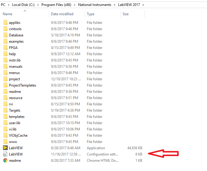

The extension might not show, depending on your explorer settings.
However, if the file is really not there, maybe we have a permission issue and LabVIEW cannot write to that location for some reason. Do you have admin privileges? What happens if you start LabVIEW in admin mode (right-click...run as administrator)

Since every LabVIEW installation has a LabVIEW.ini file, it's possible that your file was eaten up by the same problem that prevents LabVIEW to start. Not a very useful info, though.

I am having admin privileges, but i think LabVIEW configuration setting (.ini) file is missing in my C:\Program Files\National Instruments\LabVIEW 2017 folder. what should i do now to resolve this issue.

There is not much to do. If LabVIEW.ini is not there, LabVIEW simply creates a new ini file with a few default settings... if it can start of course.
