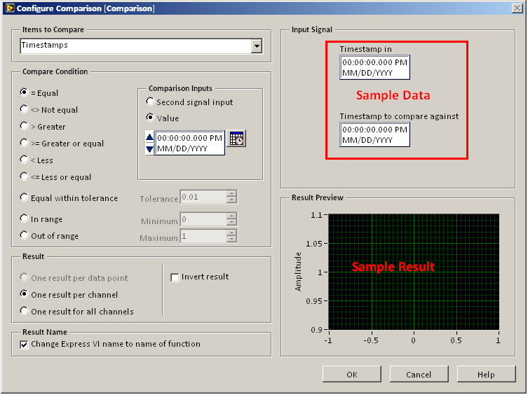

I am using LabVIEW 2012 try to compare two timestamps data using "Comparison Express VI"
When set "Items to Compare" to Timestamps and try to connect timestamp to the input of the VI, I got a broken wire.
How to use the "Comparison Express VI" to compare Timestamps?

the express comparison funtion allows you to do comparisons based on the timestamp (t0) of dynamic data (signals). It is not for comparing naked timestamp data. Big difference. (did you read the help?)
To compare your timestamps, simply use one of the plain comparison functions.
But the Express VI configuration is confusing.
