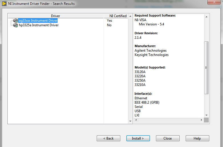

Instead of the keyword "3325B", search for "3325" under "Agilent Technologies". I guess the "ag33xxx" instrument driver is also compatible with the 3325B subversion? See screenshot below.
Alternatively, use the following driver (EXE installer): http://sine.ni.com/apps/utf8/niid_web_display.model_page?p_model_id=441

Unfortunately neither of those are drivers for the 3325B (the one at the link is though).
However, my problem is the dialog not seeing anything other than LabVIEW 2017 minimum drivers. In LabVIEW 2014 I could see the other drivers and install them from the dialog. I'm starting t think there s a website issue because I uninstalled all the NI software and reinstalled it but only installed LabVIEW 2014, NI 488 and NI VISA and now I can still only see those 2017 drivers.
