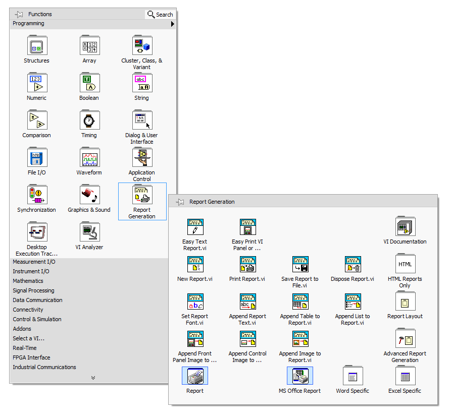

with LV2017 the RGT usually is included with your LabVIEW license. No need to install from "3rd party" (whatever that means in this context)…
Screenshot from my LV2017 installation:
NI decided to include this toolkit into "default" LabVIEW somewhere around LV2014, so no wonder you don't find any newer separate toolkit than "RGT for LV2013"!

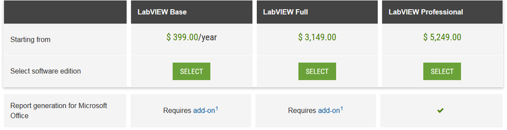

I'm running the full version, not the professional version. its included in the pro version but unfortunately not the full version...
When you call your local sales rep you may also discuss on upgrading your current license from Full to Pro:

I spoke with my bosses and I guess we need the application building stuff too down the road so I will simply be upgrading to the professional version.... ideally 2019.... and that will take care of this issue... However, I'm going to leave this unresolved until I get an answer on my original question in the event that other people come across this issue in the future.
