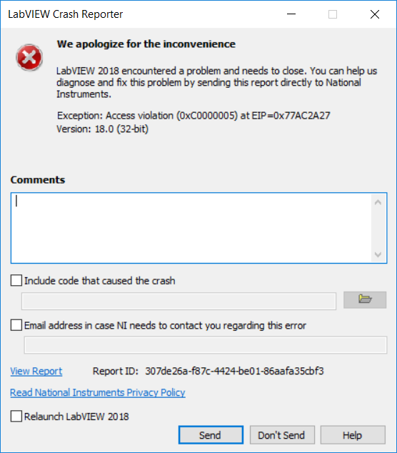

Yes, it crashed on me, as well.  I ran it twice -- the first time, it just "disappeared".  When I restarted LV 2018 (32-bit), it "recovered" the files.  The second time, I ran with Highlight Execution on to see where it crashed.  It seemed to have just entered the PM routine.  I sent the Crash Report, along with your VI, off to NI (as requested by NI).

On my PC the crash doesn't open the LabVIEW crash reporter.
I hope NI can fix this as soon as possible.
