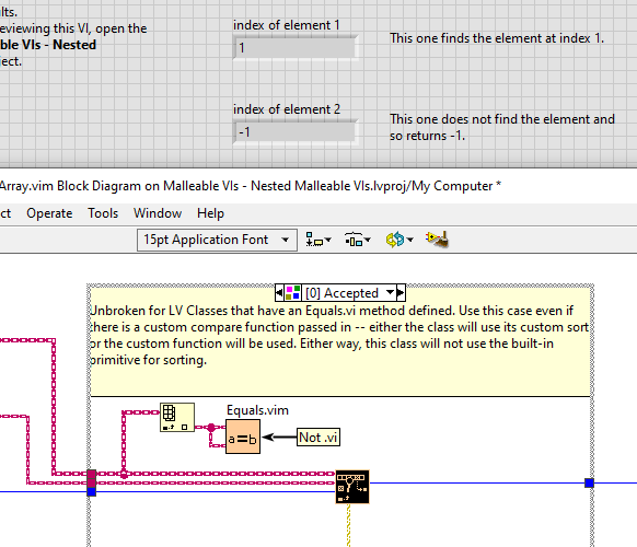

I came up lesson Malleable VIs - 2b.vi where two classes are created, one with a built-in equals function and one without.  The one with the built-in function is supposed to call the built-in equals function code from the class and thus find the DeF in the def element of the stored original array.  Mine is returning -1, not found on both classes.

The problem appears to be in the Type Specialization Structure for the Search Unsorted 1D Array.vim.
The first case is listed as the following:
Unbroken for LV Classes that have an Equals.vi method defined. Use this case even if there is a custom compare function passed in -- either the class will use its custom sort or the custom function will be used. Either way, this class will not use the built-in primitive for sorting.
However, it calls directly the Equals.vi of EqualComparable.lvclass.
If you replace this with the Equals.vim (found in the Search Unsorted 1D Array Core.vim), then the VI behaves correctly.
think this is the expected outcome and it appears to handle the two cases (has Equals.vi with appropriate conpane, does not have Equals.vi) correctly.
I'm not exactly sure why this is the case - it appears the output of the Index Array doesn't correctly propagate maybe?
