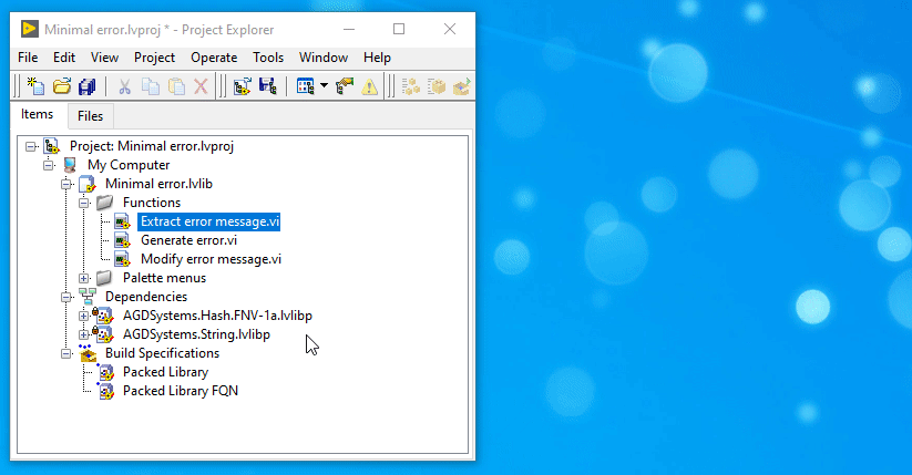

Why are true project dependencies not shown?
I have a library that shows two PPL dependencies when opened in a project.
I then open one of the VIs in that library which loads it into memory.
A new dependency is added...
I close the VI and the dependency disappears.
Does anything work correctly in LabVIEW?...Does anything work correctly in LabVIEW?...
I have cleared both the compiled object caches, performed a mass compile on the directory, closed and reopened LabVIEW and created a new project and imported the library, but still the same result.
Does this mean we can't trust the LabVIEW dependency list? Is this a known bug/"feature" of LabVIEW?

I don't think that LabVIEW evaluates the dependencies of PPLs until they are actually loaded. Since you didn't show your block diagram I assume that the VI you are opening calls a subVI in one of the dependent PPLs. The string library is a dependency of the PPL. If you move the PPls into the project itself, not listed as a dependency, then I think you will see the string library in the dependency list.

Thanks for the input both

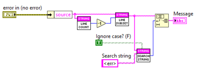

The block diagram of the VI in question:
As you can see, it called all 3x String.lvlibp functions directly. The other files in the Minimal error.lvlib used the FQN version of the PPL. AGDSystems.String.lvlibp is basically the same as String.lvlibp, just built with the updated name.
It wasn't until I'd built the Minimal error library into a PPL and used it in multiple places/projects that I realised it still had a dependency on the older PPL (hence my frustration).
For a larger project/library where multiple VIs are not currently in memory, this could (and probably has, come to think of it) cause some confusion.
For this library I would have expected it to load all the VIs into memory, obviously I'm unsure of the decision process behind LabVIEW deciding to load some VIs and not others 🙂
Probably right about the PPL loading. I've lost trust in the dependencies list now. I suppose ideally all VIs should be manually loaded into memory before assuming it's correct.
