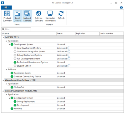

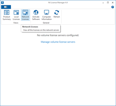

Hi Guillermo,
I am using local licenses. So I think it might not be a license issue?
Local LicenseLocal License
Network LicenseNetwork License

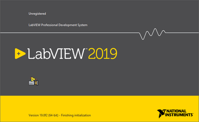

The first image (in the first post) does say "Unregistered".
That doesn't seem right... It should list name, company, serial nr., license type (this is listed).
I'd try unregistering, re-registering, reactivating, and such...
The Professional version is Licensed.
Qestit Systems
Certified-LabVIEW-Developer
Message 5 of 10

@Yamaeda wrote:
Not according to the splash screen.
