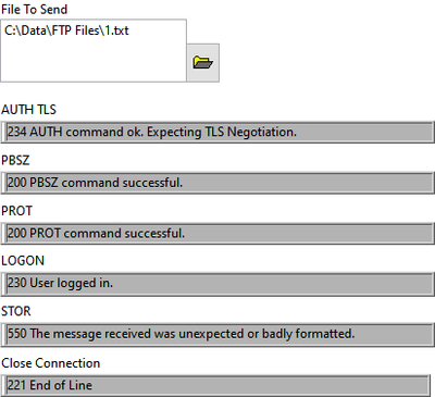

I have made some FTPS VI's of my own and following the RFC-4217 I believe I have most of it working. I send the AUTH TLS command and then when I receive the 234 back, I start the TLS. I then send the PBSZ 0 command, followed by the PROT P command. I get responses back for all these commands that match with the RFC. I then logon with USER and PASS, and get the expected 311 then 230 response.
I still get a 550 error when trying to send a file so I assuming there is something buried in the FTP STOR command that I still need to modify.

After I send the PASV command, I can establish a TCP connection on the data port, but I can't figure out how to make it a TLS connection. If I don't make it TLS I get an error 62 from the TCP write that is writing all the data from the file in 1024 byte increments.
