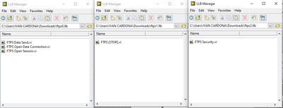

I am trying to test your solution but you need to attach these 2 vi.
AuthTLS.vi
FTPS-PBSZ.vi
Thanks for your help,
Message 13 of 21
(4,868 Views)
Those files are in the FTPS#.llb that I attached. Are you not able to get to the files from the llb?
Here are the two files as well if you can't get them from the library.
Message 14 of 21
(4,860 Views)
those vi are not in the libraries that you put.
Message 15 of 21
(4,856 Views)

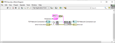

The "FTPS Open Session" has AuthTLS as a SubVI.
"FTPS Security" has the PBSZ as a SubVI.
When I download the llb's from my earlier post, the two SubVI's are present in the VI.
Message 16 of 21
(4,849 Views)
the main vi FTPS Open Session and FTPS Security are inside the library but the sub vi AuthTLS and PBSZ are not, so when I open it from my PC it does not find them.
It is possible that these 2 sub vi are not in the dll but they are in your computer

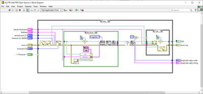

I also cannot find these two VIs:
AuthTLS.vi
FTPS-PBSZ.vi
adekruif, I see that you tried to include snippets of them, but when I download them and drop them into the block diagram, the AuthTLS png just tries to load the AuthTLS.vi from <vilib>:\FTPAuthTLS.vi, which of course doesn't work because I don't have the VI in my <vilib>.
Would it be possible to drop the actual VI files into the forum? Much obliged! (and also for figuring out how to do this in the first place!)
