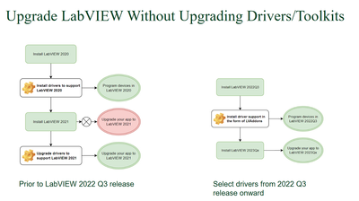

Slide taken from https://www.ni.com/content/dam/web/pdfs/niconnect/2022/austin/NI_Connect_2022_What_is_New_in_LabVIEW...
As far as I understand, drivers versions pre 2022 are not backwards compatible.
Yes, tech support has recommended to just wait!
I don't understand why they are releasing LabVIEW 2022 Q3 and advertise FPGA Improvements (see linked slides) but do not release updated drivers😤
Be careful there.  The LabVIEW feature is to allow drivers to be installed into a special folder that can be used by any LabVIEW version (after 2022 Q3).  The drivers still have to be updated to install to that folder.  I never did get a roadmap as far as when drivers would be updated to use this feature.
Even then, NI kept backwards compatibility for 3 previous versions of LabVIEW in the drivers.  A 2022 Q3 driver is still compatible with LabVIEW 2019.
Message 4 of 11
(7,545 Views)
Thank you crossrulz for the clarification.
This new capability is much appreciated. However, it does not help me now. It would certainly help in the future (eg. I'd have drivers with version 2022 installed and want to install LabVIEW 2023).

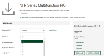

According to NI tech support, a release of "NI R Series Multifunction RIO" driver will be released in the fourth quarter of 2022, between October and December.
This is definitely not the timeline I am happy with. To summarize: It takes NI up to 5 months from releasing LabVIEW 2022 Q3 (July 23rd 2022) until it is actually usable for FPGA (R-Series) development!

Update: NI has released a driver on 10-12-2022 which supports LabVIEW 2022 Q3 (https://www.ni.com/en-us/support/downloads/drivers/download.ni-r-series-multifunction-rio.html#46456...)
