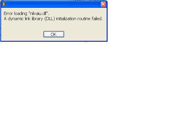

Hey guys,
I'm wondering if this issue was ever resolved. I just installed Labview 2009 on the computer and I'm getting the attached error when I open one of my written applications. The application is communicating with the DAQ card as well. Any help would be much appreciated.
Thanks.
21517i3C16ADE9DDA3F79E
Message 14 of 21
(3,923 Views)
