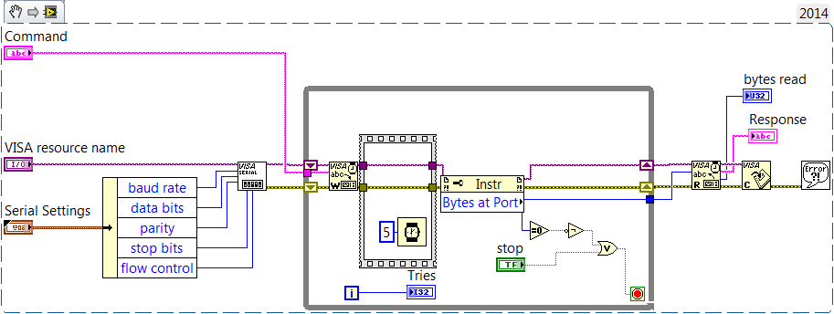

I got a similar issue trying to communicate with an arduino board.
Serial query.pngBasically I'm writing until I have available bytes to read at the port.
You can play with the 5ms delay, and you will see how many tries you need to do before actually reading something.
