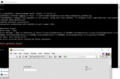

LabVIEW CLI - RunVI operation failed.
Can anybody please help with this error? I tried all the possible options but could not fix the issue.

Did the VI have the predefined connector pane interface as specified here?

Yes. You can see in the vi connector  pane(in the attached screenshot). Followed the same format recommended by NI.

I found this KB which seems support my suspicion of connpane pattern mismatch. The color icons on your connpane seem to be correct but did you check the exact data types? The input should be 1D array of string and the outputs are I32 and string.
Message 4 of 10
(4,631 Views)
My bad. I had referred the KB earlier but, I did not notice the 1D array of string, I overlooked it as string input.
Thank you for pointing out the issue. It's really helpful, I appreciate it.
