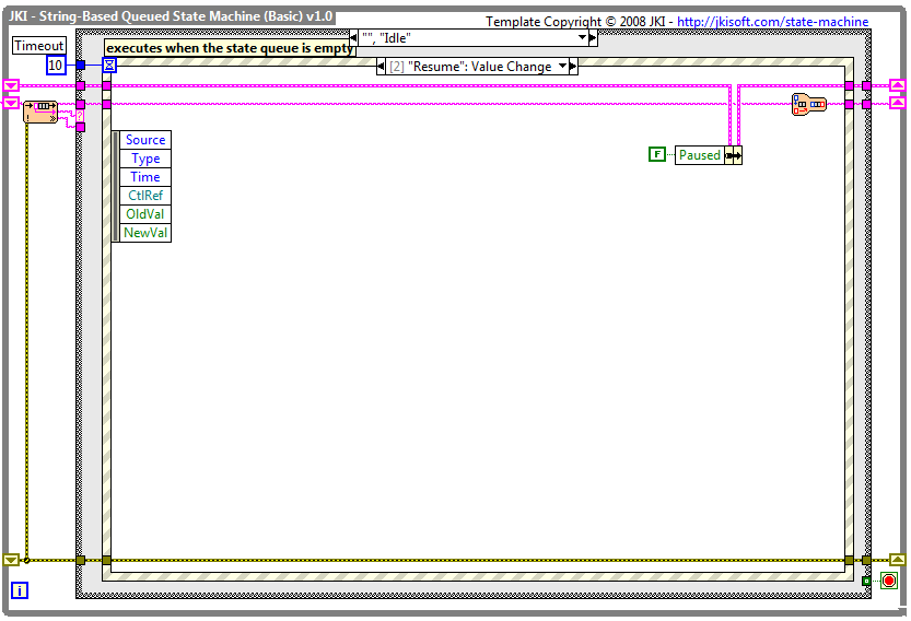

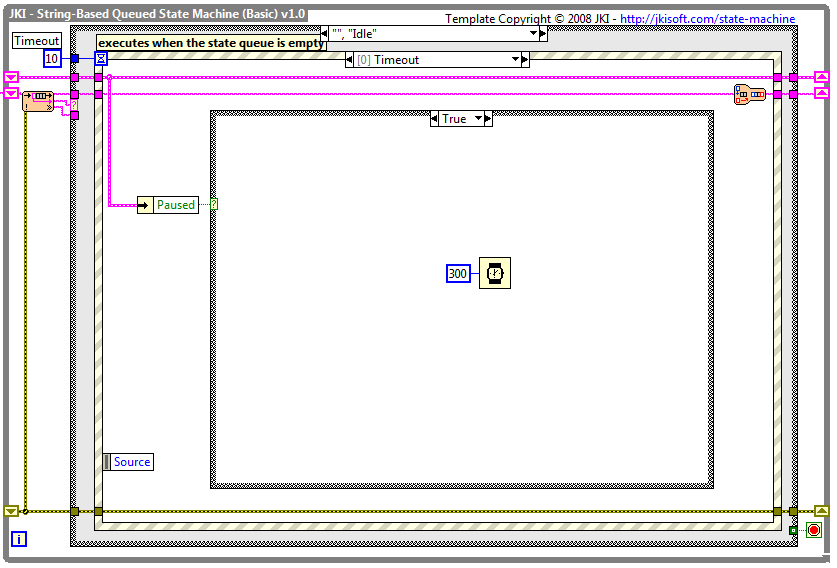

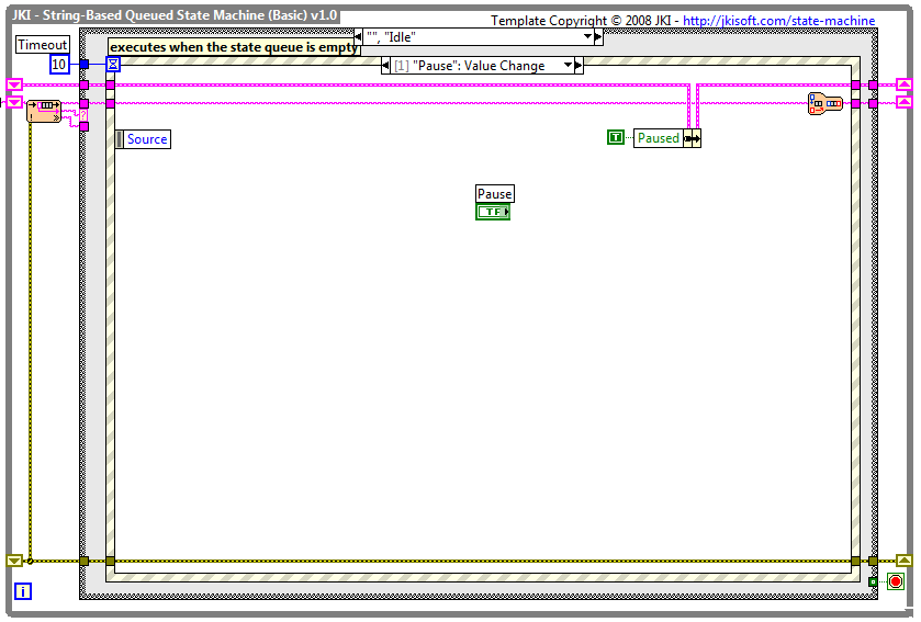

As altenbach said, fix your event structures.  There should really only be a need for one event structure, especially for a simple VI like this (I counted 3).  This is the second time I have recommended this today but go get JKI State Machine.  I use that as the foundation for most of my interfaces.
Here is one way to handle the Pause with JKI.

JKI is the exact same construct that you have used in your VI except that it is string based and contains a cluster of data elements that you define, much like a class, that are always available in any state.
