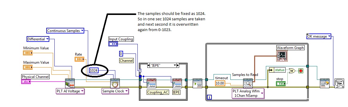

I am using analog input data DAQ(Third party). I am getting input as 1024/sec samples (fixed). When I read samples and display it through graph. I am getting amplitude in y axis and samples in x asis. I need contionous acquisition. When I try to do that the samples are overwritten and again it is showing from 0-1023. I need contionous acquisition of data. When I try to log data The samples are stored from 0-1023 qand again overwritten from 0-1023. I need to store the data (amplitude continously). samples prob.jpg

it is very easy: just create a separate "slave" while loop below the DAQ loop. Set up a Queue to send the 1024 data points to this slave loop, where you can put it into your Graph, and save it into a TDMS file.
Have a look at the Producer/Consumer Design pattern (Data) which you can reach from the "File" --> "New..." menu.

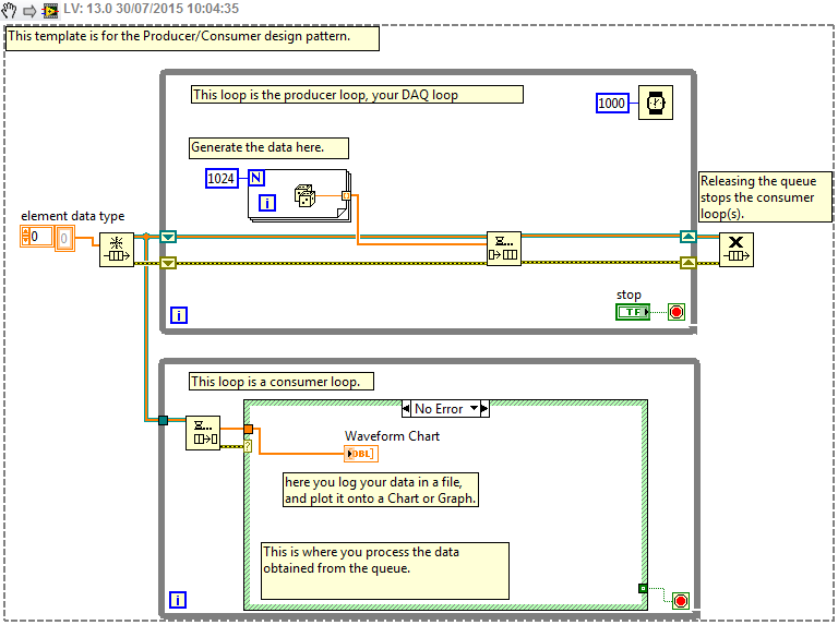

Had you have a look at the link? The Queue operates as a "communication line" between the two parallel while loops. You ENQUEUE your 1024 data points at the DAQ while loop, which data package will be DEQUEUE-ed in your Data logging/Graph while loop.
Have a look at the following example where I simulate 1024 random numbers, and insert into the Queue. Of course, this is only for example, a proper Producer/consumer pattern should have much better error handling and a Typedefinied cluster so you can send commands not only data, I do not like to stop the consumer loop in this way.
Anyway, this should give you an idea how to separate your data acquisition from the logging and presenting task! You also have to program a data logging part in the consumer loop, I would advice to use TDMS file.
Try to program it yourself, and post your VI so we can help easier!
