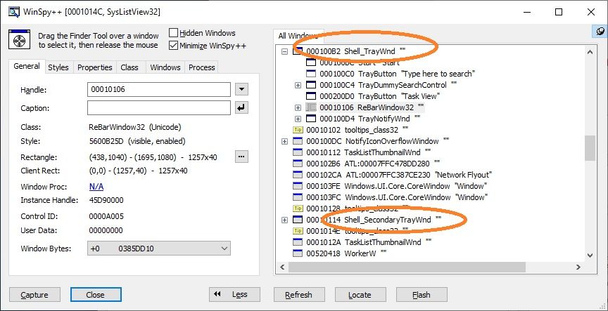

> I think 4 HWNDs for the primary taskbar alone and I tried sending various messages to each.
> I did find one that would refresh properly but it took up to 5 seconds to perform the task.
Are you sure?  What's their class name?
Should be just 2: one the primary, and the other one for the 2nd monitor.
What message did you send?
Did you try UpdateWindow()?
Does show/hide window cause flash?

If I dragged the finder tool to the taskbar the highlighted one is MSTaskListWClass, above that is MSTaskSwWClass, above that is ReBarWindow32, above that is the Shell_TrayWnd.  I tried sending messages to all of these.  Issuing the SendMessage of 0d1053 (TTM_Update) causes the taskbars to refresh but like I said it varies on how long it takes and for me would freeze for 5-10 seconds.  Other messages I tried was WM_UPDATEUISTATE, TTM_UPDATETIPTEXTA, TTM_UPDATETIPTEXTW, LVM_UPDATE, and FM_REFRESH_WINDOWS, but nothing happened with these which I got from this list..  Are any of these the UpdateWindow() you are referring to?
Show/Hide with a 0ms wait between did flash the window very quickly, but I found that even if you are performing a move operation with a drag, it still sticks to the mouse.  A single flicker of such a short amount of time, only once every window moves is totally fine.
