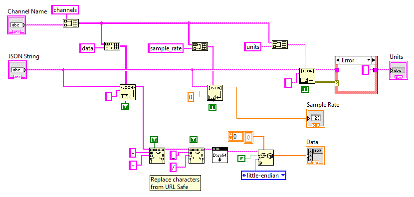

I have a program that I wrote that works fine on Windows, but does not work when distributed to a coworker that runs LabVIEW on OS X. I don't currently have access to OS X for debugger, but was wondering if anyone sees anything that may be an issue for cross-platform compatibility.

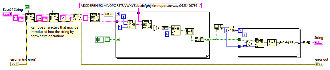

The program reads a JSON string from a text file that contains base64 encoded data, and converts it to an array of doubles. I know that there is nothing fundamentally wrong with the approach since it works without issue on Windows. I believe the problem is somewhere in the json_read_channel.vi or the base64_decode.vi. When run on OSX, the program will just hang and never throw an error (which is what makes it difficult for me to debug remotely on an OS I am not familiar with).
Does anyone notice anything that seems out of place when run on OS X?
Thank you!

base64_decode

It would be helpful to have some data and the expected results for that data.
When I type a few random characters into the JSON String, the program executes and exits.

The attached text file ("JSON String") for use with a "Channel Name" of "Weight FL", when run through the program should result in an output "Data" array with a length of 160 and a "Sample Rate" of 32.

Works fine on LV 2016, 64 bit, on Mac OS X 10.11.6, El Capitan.
You might try wiring up the error clusters and adding error indicators and see if those give your coworker any clues. What OS and LV versions are used where the error occurs?

The code was written with and tested on Windows in LV 2014. The error is happening on El Capitan with LV 2015.

It also runs fine for me in LV 2015. And on LV 2014.
