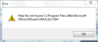

However, when I now right-click on the Range Node and ask for help, I get the following window:
They have the correct folder setup (that is where the Office 2010 files/folders are located), but there is no VBAXL10.CHM file.  There is a file one level down, ...Office14\1033\VBAOWS10.CHM, but that is the only file starting with VBA installed on my system.
There (logically) must be a way to get back the functionality that existed in the older version of LabVIEW/Windows/Office I used, probably 3 years ago, that had a working VBA Help system integrated into LabVIEW (so that when LabVIEW offered Help for Range, you got ... Help for Range, instead of an Error Message).  Any assistance would be greatly appreciated.
P.S. -- I did try downloading the "missing" file from the Web and putting it where LabVIEW said it wasn't, but that didn't do anything.

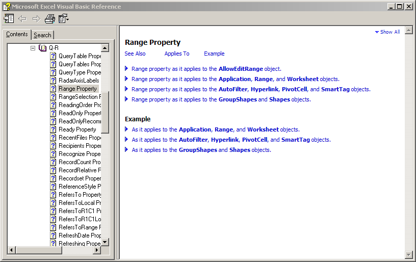

Thanks for the comments, guys.  I actually found the "system that works" -- here is what happens when I ask for help on the Range Node on another PC (to be described shortly) --
Now, this is useful!  I realize that NathanD is right -- I'm (probably) not using the LabVIEW Office Toolkit, but using Active X calls directly.  When I first started doing some Excel work (dragged kicking and screaming, because my colleagues wanted to control their experiments using an Excel spreadsheet to organize their stimuli and do simple data analysis), I tried the LabVIEW Toolkit, but found it quite slow, with Active X an order of magnitude faster (and more capable).  I even developed a system whereby I could create a "LabVIEW spreadsheet" as an array (rows) of clusters (columns), where the data types in the cluster were things like strings, integers, floats, timestamps, and booleans, and write a LabVIEW/ActiveX set of routines that would write the array out as an entire WorkSheet, using the names of the Cluster Elements as the Excel Headers and the contents of the clusters as the row elements (handling the type conversion as it went).  Made for much cleaner LabVIEW code (though there was quite a bit of "behind the scenes" work with variants ...)
Anyway, the System That Works is a Windows XP PC with Office XP (which, incidently, seems to have the internal name Office 10, the same name that seems to be linked to the VBA Help File) and LabVIEW 8.6.  I'm going to try to build a "clean" VM with just these component and see if I can duplicate my success.  If so, I'll try keeping Office the same and upgrading LabVIEW -- maybe that's the answer.

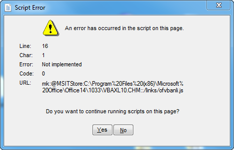

Very interesting result.  As I said earlier, Office 2003 comes with the VBA Help Files, and if I open them and search, say, for Range Properties, I get the same information that LabVIEW gave on my "working" system when I click a Range Property Node and ask for Help for Range.  However, when I try to get the same information in the same way, i.e. from within LabVIEW, I get an error message saying "An error has occured in the script on this page".  Curiously, it shows me almost the same "page" that I saw when I looked at the page "manually" by opening the Help file and looking up the Range property -- only some of the links seemed incomplete.
     Just for fun, I copied the .CHM file to the corresponding Office 2010 folder on my Windows 7 machine, and tried it there with LabVIEW 2011.  A Big Fat Nothing -- asking for Help on Range gave me no error, and no information.  So I opened the Help File, navigated to Properties, and asked for Range.  I got the following:
Note that, with the exception of the appearance of the Window and the details of the path to the file, this is exactly the same error message I got on my XP/Office 2003/LV 8.6 system when I asked LabVIEW for help.

Well, with the information from that error, you might be able to find a solution.  See if any of these links help:
http://answers.microsoft.com/en-us/office/forum/office_2003-excel/an-error-has-occurred-in-a-script-...
http://support.microsoft.com/KB/892675
http://support.microsoft.com/kb/902225
Message 9 of 12
(10,737 Views)
Nathan,
     Thanks for the links.  I spent quite a bit of time tracking these down, and trying one or more of the suggested fixes.  The underlying problem these seem to be addressing is a "feature" Microsoft introduced in one (or more) of their updates that results in an incompatibility between two of their components, hhctrl.ocx (which is the Microsoft HTML Help Control, an ActiveX file that provides the Web interface to the .chm file) and user32.dll (which handles the Windows API).
