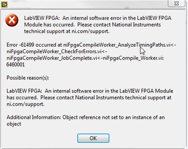

But when I try to compile the VI after a few seconds the following dialog with the error pops up:

no that doesn't work. - Same issue.
My VI will be compiled correct on my local PC.
But not on the new set up Linux machine.

On Linux I only installed the XILINX ISE modules. Nothing else. I will try to repair the installation there.
I am new to LabVIEW and FPGA and my team leader is on vacation at the moment.
He is well known on LabVIEW and FPGA. But he doesn't know something about compiling the FPGA on a remote Compile Worker with Linux.
Compiling a VI on a remote Windows PC which is Compile Server and Compile Worker in one, works fine...
