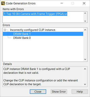

I've got this problem for a while . I try to build the bitfile from the example "1-Tap-10-Bit Camera With Frame Trigger" but the error occur with the message
CLIP instance DRAM Bank 1 is configured with a CLIP declaration that is not valid.
Change the CLIP instance configuration or add the relevant CLIP declaration to the target.
When I click 'Show error' it lumps to lvproj file and the red '!' appear in tab DRAM0 and DRAM1.
I don't understand What's CLIP and don't know how to fix this issue.

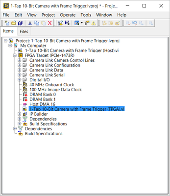

This is what the 1-Tap 10-bit project looks like when I open it on my machine (LabVIEW FPGA 2015, IMAQ I/O 15.0):
Are you opening this example directly from the example finder? Can you confirm that you're working with NI-IMAQ I/O 15? IMAQ I/O is a different driver than DAQmx.
If the answer to both of those questions is yes, it seems like something has happened to the example on your computer (i.e. someone made changes and then saved them without creating a new copy of the example in a different location). You should be able to restore the example to it's original form by deleting the example source files off your computer and then repairing the IMAQ I/O driver. Try that, and let me know if you still see the CLIP declaration in the project after doing so.
