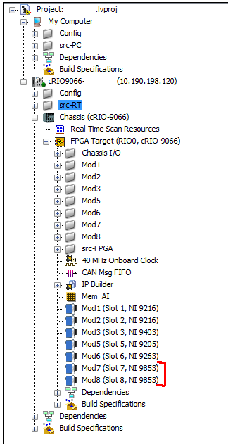

Hi, when I create new FPGA project on cRIO-9022 I have the following issue:
-FPGA I/O module when inserted into block diagram shows as on screenshot.
My question is, what am I doing wrong/ what configuration has to be done.

Hi Partial,
AFAIK the NI9853 needs to be programmed in the FPGA. It will not work in the RT target…
Atleast that's what I do since years:
(3,009 Views)
Yeah, I missed target device, I should create VI on FPGA module as you said. Now it is working fine. Thanks for reply.
