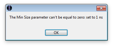

If I pass this string to a One Button Dialog function, the display will look like so:
If I wan't to go to the VI that generates this dialog, my only option is to type in the string show above (or part of it) and search for it.
Unfortunately, since the string constant uses the "'\' Codes Display" style, these are two different strings for the search tool, and the string is not found.

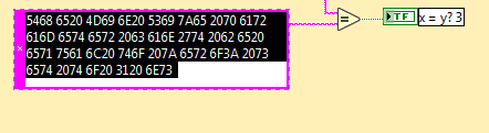

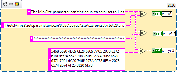

Try this piece of code:
The result is:
Ergo, as far as LV is concerned, these strings are identical.

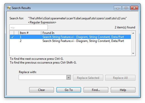

I understand that a "text seach" is in principle a different thing, so I tried the following:
1. Select the content of the "\ Code Display" string above and paste it in the Search box.
2. Run the search in the VI above. You will be interested to find out that there are two hits:
The first one is:
The second is:
So now we have entered the rabbit's hole.
The '\' Codes Display string is NOT found but the plain text style one is actually found!
Clearly the developers had some very precise intent in coding the Search for text tool. Too bad they did not share their intent with us users...
(4,168 Views)
