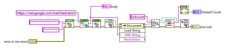

I was playing around with this recently to receive the number of unread emails (Gmail) I have - here's a screenshot:
The first 3 VIs are the ones you want to use - the rest of the VIs just read the XML data.

2) I think the VIs are located under "connectivity > http". If not, search the LabVIEW help to find them. I don't know what version of LabVIEW they were introduced in - they're certainly in LV 2011, 2012 and 2013. You can also search for VIs using the magnifying glass on the palettes or quick drop window (ctrl+space).
The VIs are called HTTP Open, HTTP Get and HTTP Close. That's all that is needed to get some data from a webserver (your ATMEGA32). I'm sure you will find examples in the LabVIEW example finder.
