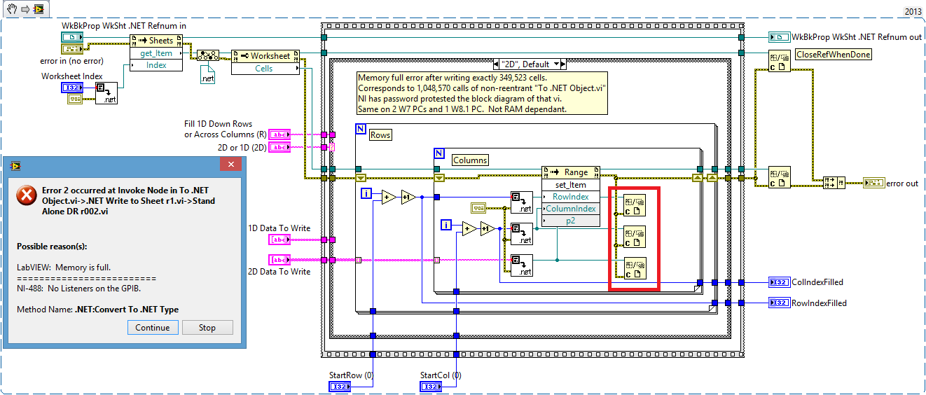

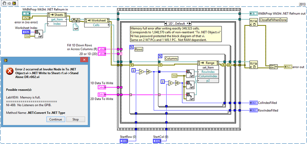

We are using the Microsoft.Office.Interop.Excel(15.0.0.0) .NET Constructor to create *.xlsx reports in production.  We use LabVIEW to reduce the data.  Normally *.csv files created in production contain only 96,320 or so cells.  However, we need to make longer test runs for QA/QC.
The problem is: After exactly 1,048,570 calls of the non-reentrant 'To .NET Object.vi' we encounter the memory full error in vi snippet below.

Thank you for your response Chris.  The *.scv data file is 19.9 MB.  Rows = 32,705 and Columns = 80.  Cells to write = R * C = 2,616,400.  That is 7,849,200 + 2 previous calls to the non-reentrant 'To .NET Object.vi'.  Need 1 call each for row number, column number and the data to write.  Since we can manually copy and paste the *.csv data into an Excel data reduction spreadsheet template (*.xltx) and the data array is small by modern Excel standards I do not think we have a row or column limitation with Excel.
The objective is to do everything with LabVIEW at the push of  button.  That is why NI customers purchase their product.  Valued customers do not expect any aspects of the product they purchased to be intentionally limited in some way.
In this case it seems NI has limited the number of calls to that vi by making it non-reentrant.  Thus the memory LabVIEW can use fills up.  Presently using LabVIEW 2013, 32 bit, but will try the 64 bit version next but I not sure if that will help.
Since data coercion impacts memory utilization I tried a 'to variant function' in front of each 'To .NET Object.vi' call.  That got rid of the  'coercion dots'.  This effort produced the exact same result stopping at the exact same point.
I need to know directly from NI engineers if I am wasting my time trying to use a product they have limited.  Good for LabVIEW Report Generation Toolkit sales though.  Perhaps I will try a trial license (if available) of this add-on toolkit.  If it works for 2,616,400 cells then we may understand more about what NI did with 'To .NET Object.vi'.

Actually it's most likely a LabVIEW problem, though can be easily worked around. The greenish wires are all LabVIEW refnums. LabVIEW only can create 2^20 refnums of a type (All .Net refnums are one type, file refnums another, etc.). This means after creating 1'048'576 open refnums of any particular type LabVIEW has an out of refnum error, which because there is no specific error code for this, is reported as an out of memory error.
The solution is to close each refnum after it is not used anymore, which will return that refnum to the resource manager for reuse.
There would be likely some serious performance optimization possibilities, by creating the according refnums only once outside of the loops, casting them to the specific .Net object type (Numeric/String) and then inside the loop assign the actual value through a property or method access node and pass it like that to the set_item method, and of course closing the refnum after the loop.

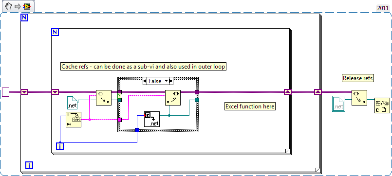

Some caching should be nice, as mentioned.
Cache .net refs.png/Y

While this caching would help some for the column index it has its own overhead of having to convert the index to a string to then do a variant attribute lookup, so I would guess this is not really that beneficial.
And as extra note there is another To .Net Object refnum in the beginning of the function that needs to be closed too!
I actually recreated the 'bug' earlier today by simply having a loop creating .net objects of the loop-counter (i), it only created some 1-200 objects/second, so the overhead of a variant lookup is negligable.
/Y
