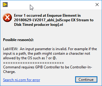

  1. I altered NI-Scope EX Stream to Disk by adding custom file name prefix (YYYYMMDD-HHMMSS), and I began to get the error as shown below at Enqueue Element for an invalid input parameter.
  2. The other change I incorporated was to time-restrict the producer loop to 1.5 seconds and collect data for just this time period.
  3. As stated in on of my previous post here, I am not sure about how to use a STOP trigger to the Stream_to_disk example so that I don't have to time restrict the collection of data from the producer loop based on my sampling rate/freq.

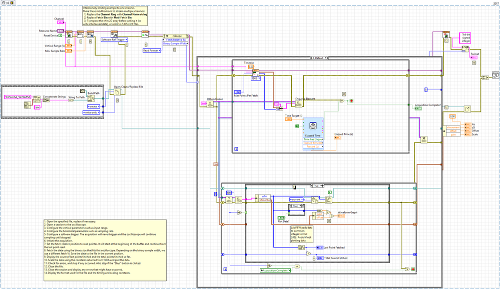

4. Below (also attached) is the altered example
20180629-timed_producer_loop.png20180629-timed_producer_loop.pngany advise on how to correct this and obtain data for a pre-alloted time period and/or using a stop trigger is appreciated.
Thanks.

Kindly upload your updated code so that equeue error can be sorted out.

Please find the attached VI

Hello asukumari,
I went through your vi and found that you were releasing the queue while the acquisition is being carried out. Secondly you have to set the boolean "Acquisition completed" to false when the vi is initialized. Find the attached code.
And one more thing rather than looking for stop trigger why dont you acquire the number of samples that will be generated during the one cycle e.g 50000 samples per cycle.
