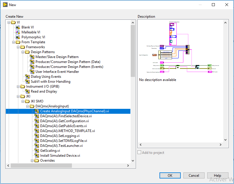

I want to create the same window like the (New..) window in LabVIEW .using LabVIEW .is that possible ? .

hi,
thank you  George Zou, all i want is when i clic to a button a window appears  and this window look like the new window . please help me to do this .

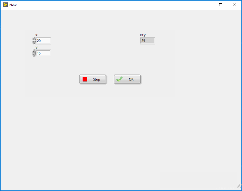

hi ,
i want to make this window .

Hi Emna,
Create a new VI, with just those 3 buttons on the frontpanel!

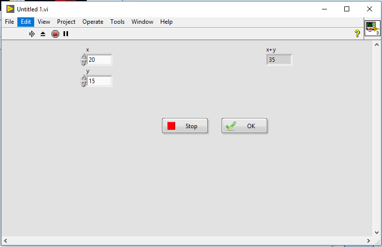

thank you for you response . run the (application .vi)  and click on ( File > Open ) .  ( i change the run time menu ) .
a window appear ( Untitled 1 .vi )  .
i want the (Untitled 1 .vi ) window appear like this .
see the code .

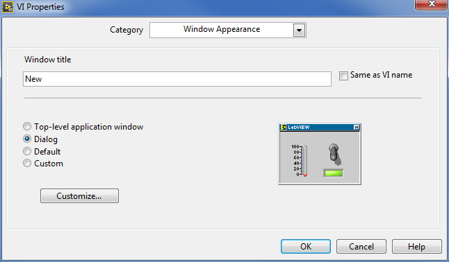

I assume you want to hide the LabVIEW menu and the tool bar.
Open the VI Properties dialog (Ctrl + I) and select Category 'Window Appearance'. There you can write a new window title and configure the VI to be a 'Dialog' when running.

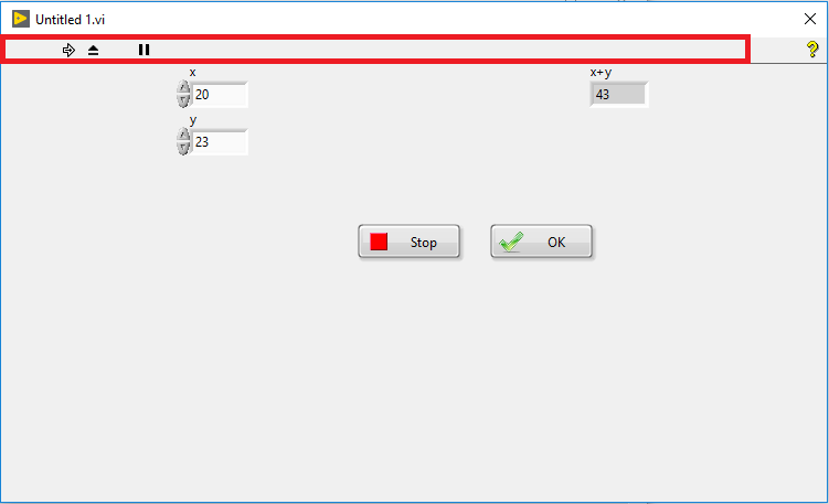

hi UliB ,
thank you so much  . but in running  mode i still have the Toolbar menu . and i have to clicks on the Run button  to obtaine the result of the Sum    .

hi ,
to hide the tool bar menu you have to do this :
* change your appearance window to this :
* Select "Show front panel when called " from " SubVI Node Setup " .
You could find the code below .
