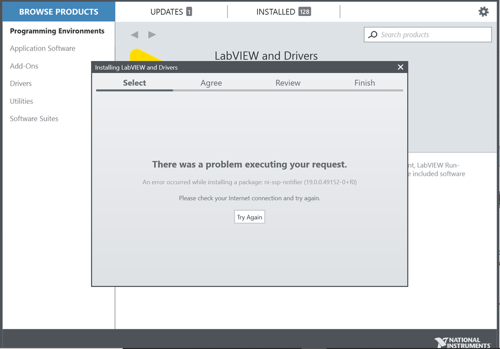

LabVIEW Not Installing
I've:
Downloaded NI Package Manager > Clicked Browse Products > Clicked Programming Environments > Clicked LabVIEW and Drivers > Selected 2019, 64-bit and English > Clicked Install. I then leave the following (default) ticked: LabVIEW, NI-DAQmx, NI-488.2, NI-VISA and PXI Platform Services and deselect all additional packages. After accepting license agreements and reviewing the summary, upon installation, I get the following error message:
"There was a problem executing your request.
An error occurred while installing a package: ni-ssp-notifier (19.0.0.49152-0+f0)
Please check your internet connection and try again." proceeded by a "Try again" button.
My internet connection is working fine.
I've done the following:
- Tried again by clicking the try again button with no success.
- I then uninstalled all NI related files through the NI Package Manager and attempted to reinstall with LabVIEW with no success.
- I then uninstalled all NI related files through the NI Package Manager and also uninstalled NI Package Manager and reinstalled with no success.
Please help.

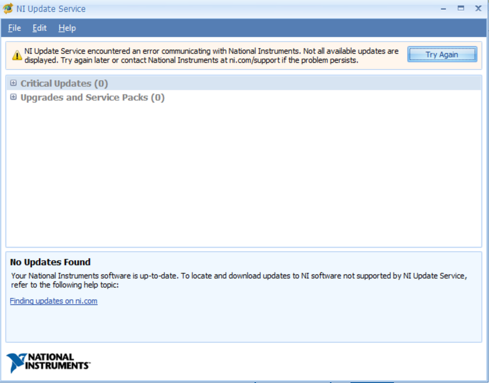

As I'm installing LabVIEW 2019, a pop up window asks if I want to be notified of updates. I have tried selecting both "yes" and "no" however the same error message has appeared in both scenarios. I then have two options at this stage; (1) "Try again" OR (2) click the 'x' button. I of course then click the 'x' button however it doesn't ask me if I want to continue installing or quit as you mentioned. It just brings me back to the screen where I go to install LabVIEW.
I have attached screenshots of both messages, hopefully you are able to view them.

Sigh -- just when you think you've figured out how to "peacefully co-exist" with NIPM, it throws you a curve.
What I would do would be to exit NIPM, reboot, and see if NI Update Service is installed (by going to the Start Menu, look under National Instruments, and see if NI Update Service is in the list).  If it is, you're done.  If it is not, go to the Web and search for NI Update Service Download -- you can find a Download for NI Update Service 19.0.

NI Update Service is installed and I updated however getting the following message:NI Update Service Window.png
I'm still getting the same error when trying to install LabVIEW 2019:
