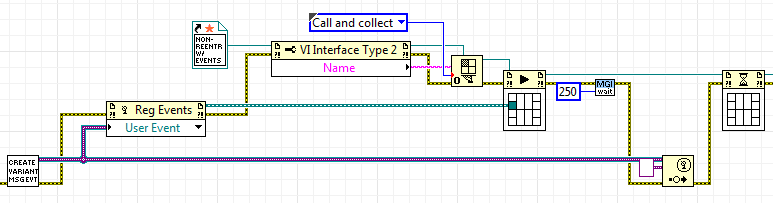

When I connect a strict VI reference to a property node, I see "VI Interface Type #" on the node. Why? What does it mean? How many numbers are possible?
Example:

It just appears because it's a strictly typed VI reference so the connector pane of the VI must match the VI. The interface type just refers to the arrangement (e.g. inputs/outputs) of the connector pane - different connector panes will have different interface types. I think the number of types depends on the number of different types of VI connector panes (on your block diagram? or strictly typed VI references?). A non-strict VI reference could have any connector pane arrangement.
I think you can change it from either the start asynchronous call or the strictly typed VI reference - it'll allow you to select different interface types.

Hey random question.  Where did you get that ring type def constant that is wired to the open VI reference?  That seems like a neat thing to have, and have be built as a constant to the options input.

The enum data represents the VI options for this method, x80 is one option we use
I’ve shared an XNode for that.  I think it’s called something like “Named Numeric Constant”.

@paul_cardinale wrote:
Or maybe it was something like “Numeric Constant with Named Bits”.
