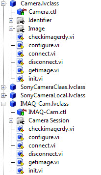

we are testing OOP in LabVIEW. I made a camera class and get this warning during build:
"LabVIEW prevented a file name collision during the build. Duplicate file names cannot be copied to the same destination. You can rename files as part of the build process to avoid name conflicts.
The following files were moved to a unique location:
C:\CTT\CTS\Hardware\Camera\IMAQ-Cam\checkimagerdy.vi
C:\CTT\CTS\Hardware\Camera\checkimagerdy.vi
C:\CTT\CTS\Hardware\Camera\configure.vi
C:\CTT\CTS\Hardware\Camera\IMAQ-Cam\configure.vi
..lots more....
'Use LV 8.x file layout' is not checked.
The VIs seem to work in the exe.
Any ideas?
Thx in advance

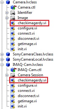

Hello Tesla1977,
looks like you used the same VI names for both classes, the Camera.lvcall and the IMAQ-Cam.lvclass. That´s why you get the warning of duplicate file names.

Camera is the parent class, IMAQ-Cam the child class, so yes, VI names are the same.
